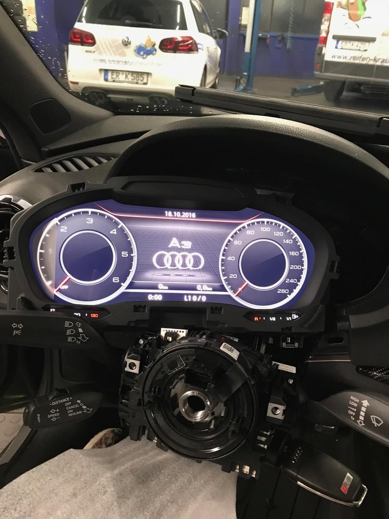

Aoon ist grad dran, das Mäusekino nachzurüsten...
https://www.instagram.com/p/BVpYgIOhbJ2/
Erster Testversuch..
Virtual cockpit retrofit consists of;
New dashboard
New instrument cluster
Various pieces of trim
MIB2 infotainment unit
New amplifier (B&O)
New wiring looms
Immo swap & coding using ODIS
Going to try and code the TTRS advanced key to the car also.
You can fit VC without a new dashboard, but I'd rather do it properly.. No point skimping!
